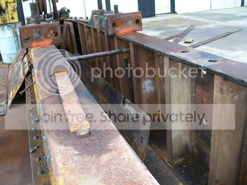

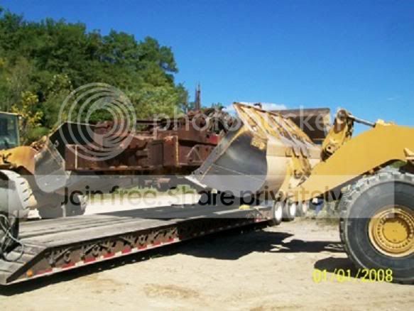

I've attched a couple of pictures that show that we did accomplish a little work when it wasn't raining.

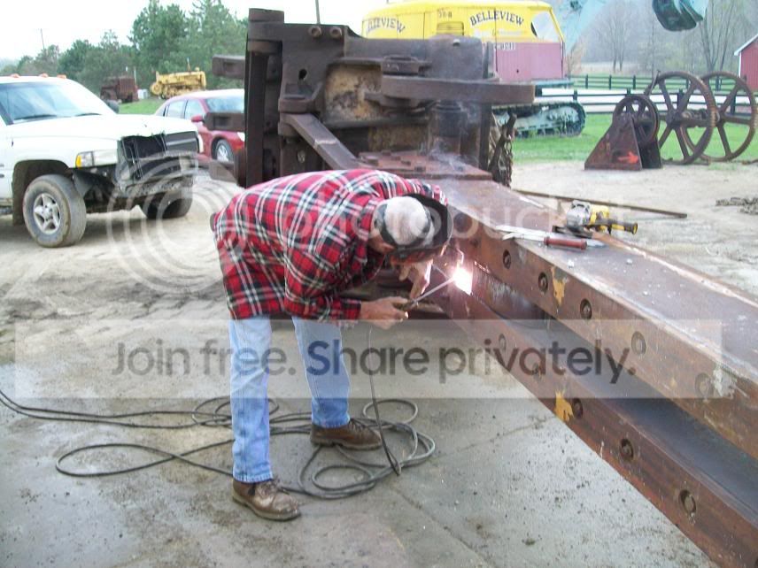

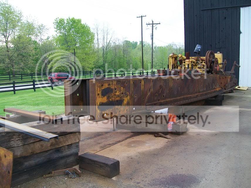

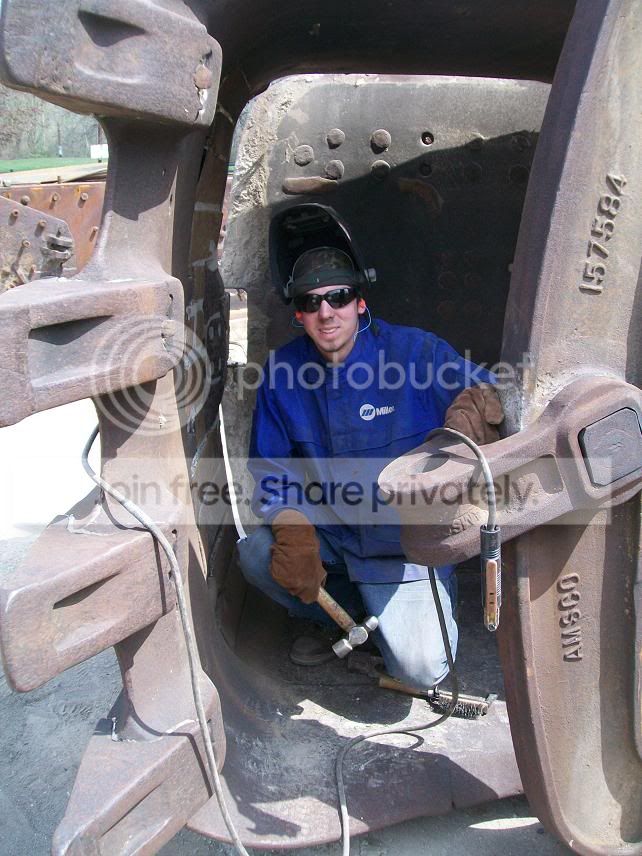

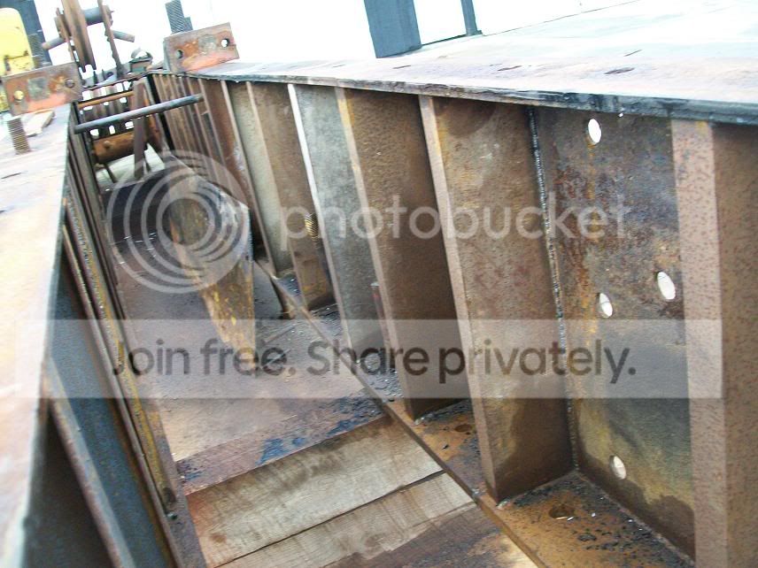

As you may remenber, the boom and dipper stick on this machine was wood, that was encased with bolted on steel plate and angles to reinforce the wood. (This was before the days of practical arc welding.) We have removed all of the wood and actually made the boom into two welded boxes, with internal bracing in critical areas. We believe that when the boom is complete, it will be stronger that the original boom. The dipper stick was treated in the same manner, but we left the original wood in place.
Removing the wood that was in the boom was a bear to say the least. It was so hard that it literally ate up saber saw blades, chewed the carbide off of circular saw blades and destroyed chain saw chains.

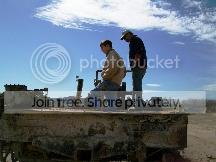

We were able to do a little work on the main car body, all of the control levers are freed up. In the process of moving, it looks like the cross heads on the main hoisting engine moved about an inch, so it shouldn't be too difficult to get the main engine turning over. We still have to free up the clutch on the main engine. I pulled the head on the right cylinder of the main engine and the cylinder walls were oily and shiny. Hoisting on this engine is going to be a little different that the other shovels, one lever engages the clutch and another engages the throttle. We may need a three armed operator.
